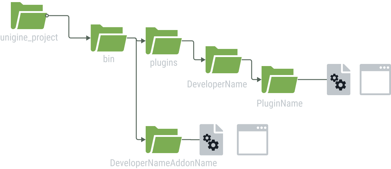

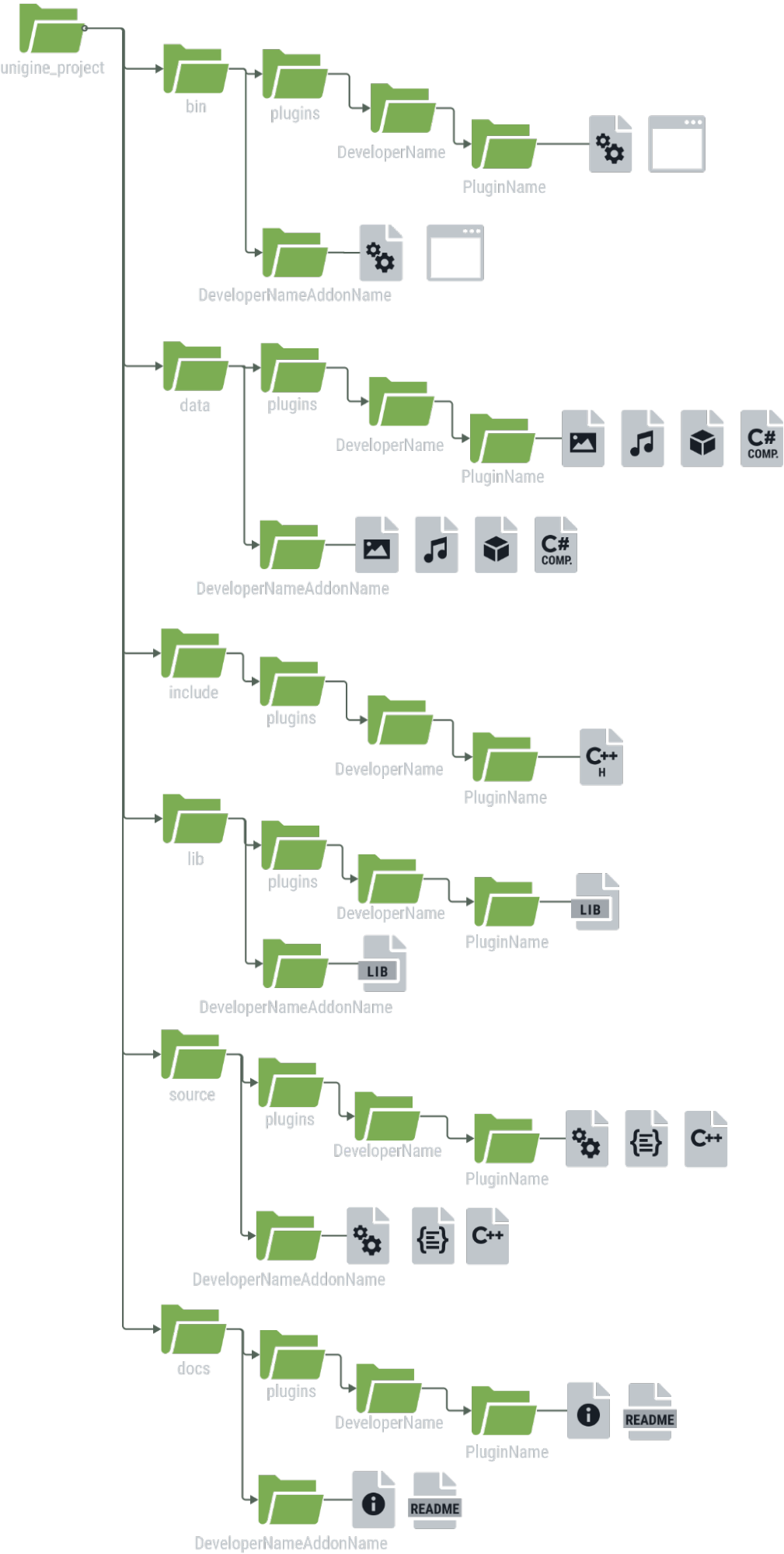

Folder Structure
The add-on can contain binaries, source files, content files, or their combination. Therefore, files inside the package should be located in the following folders depending on their type:
  • bin/plugins/<DeveloperName>/<PluginName>/
    → plugins and editor plugins binaries
  • bin/<DeveloperNameAddonName>/
    → add-on samples and launchers to launch these samples
  • data/plugins/<DeveloperName>/<PluginName>/
    → plugin-related content files
  • data/<DeveloperNameAddonName>/
    → content files and C# components
  • include/plugins/<DeveloperName>/<PluginName>/
    → files required to compile a user application (required mostly for plugins using the third party libraries; editor plugins don't require any includes)
  • lib/plugins/<DeveloperName>/<PluginName>/
    → third-party libraries for linking with the user application
  • lib/<DeveloperNameAddonName>/
    → third-party libraries for the addon development.
  • source/plugins/<DeveloperName>/<PluginName>/
    → asset source files (logic, plugins, configs)
  • source/<DeveloperNameAddonName>/ → source files for samples
  • docs/plugins/<DeveloperName>/<PluginName>/
    → readme, license and any other plugin-related info files
  • docs/<DeveloperNameAddonName>/
    → readme, license and any other info files related to running the sample or using the content files
This would help customers easily find the added package assets inside their project.

Preparing a complex package (contains code, binaries, and content)
The complex package containing various types of files must follow the folder layout.

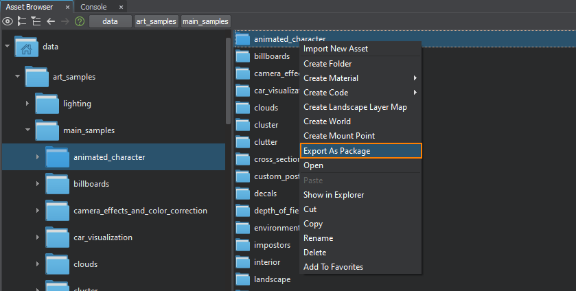

The add-on is provided as a *.upackage file created via UNIGINE Editor as follows.
  1. In the Asset Browser, right-click on a folder that is going to be a part of your package and select Export As Package in the context menu.
